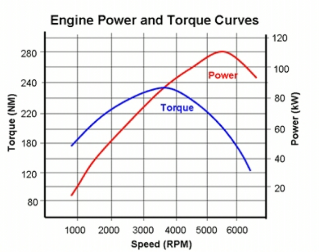

What you need to do i look at the motor power /torque curve.
power-torque-ice-jpg.91146
And the propeller power curves
Superimpose the two for the motor and the prop dia and pitch to match the two
