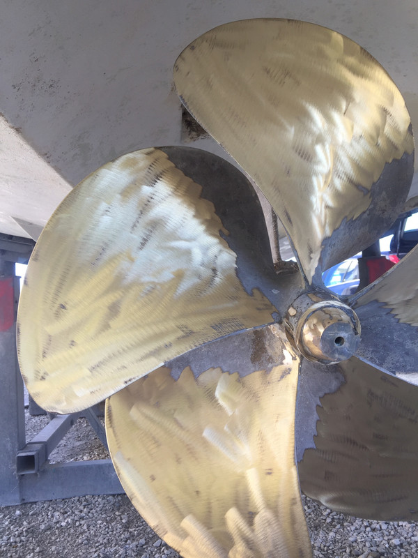

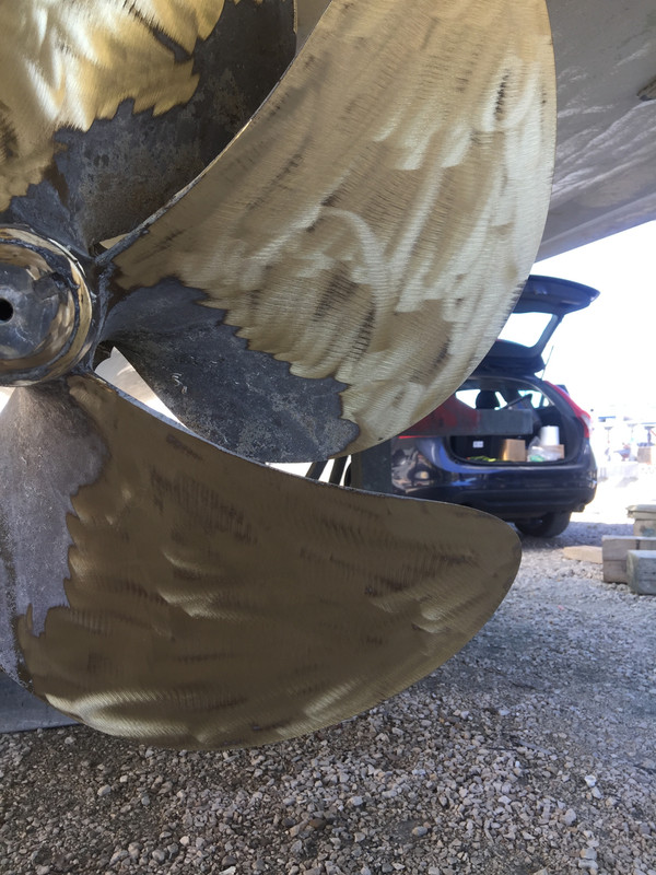

Ok, my first attempt at polishing
As you can see there is no pink. And I chimed them all again today and got beautiful notes.
Just out of interest, what do people use to get in all the nooks and crannies where the power tools don’t reach?
Bouba!!!
wft are you doing? planning to remove half the material out of the prop???
maybe the pics, but please soften your moves or you'll end up buying a new prop!
Relax it was a polishing disc on my angle grinder, it’s just contrasted against the unpolished parts. I have done a forensic fingertip test and there is no gouging or material removed
