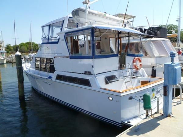

Bit difficult now as we sold that boat! Our new boat is a trawler yacht mobo in the USA and as yet we don't have a BBQ fitted, but we do have one of those George Forman type electric grills we can run off the generator or shorepower. We do have propane cooking on board but the flybridge mounted gas locker is far away from where we would want to mount a BBQ so I think we will be back to an aft cockpit fitted one with the Coleman type cartridge. USA cylinders are refilled rather than exchanged and buying an extra spare one would cost a good many years of any savings over disposable cartridges.

Average! Moi? After 40 some years with sails we are moving to live aboard in Florida full time on our new to us 'fast trawler'. We have a cockpit that is ideal for fishing and BBQs, but not quite the same as we had on our yachts over here!
