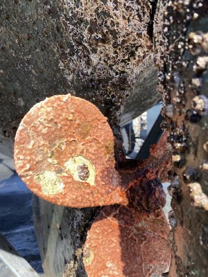

I had it put on 2 years ago by a yard when they did my copper coat, it completely failed and was redone the next year and completely failed again. IMG_7388.JPG
