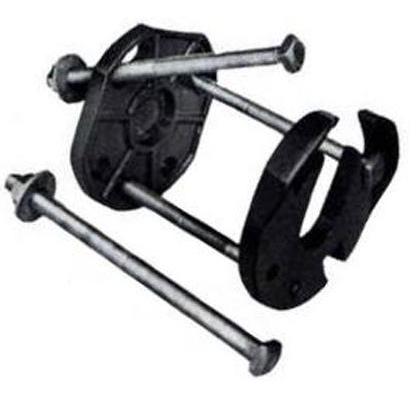

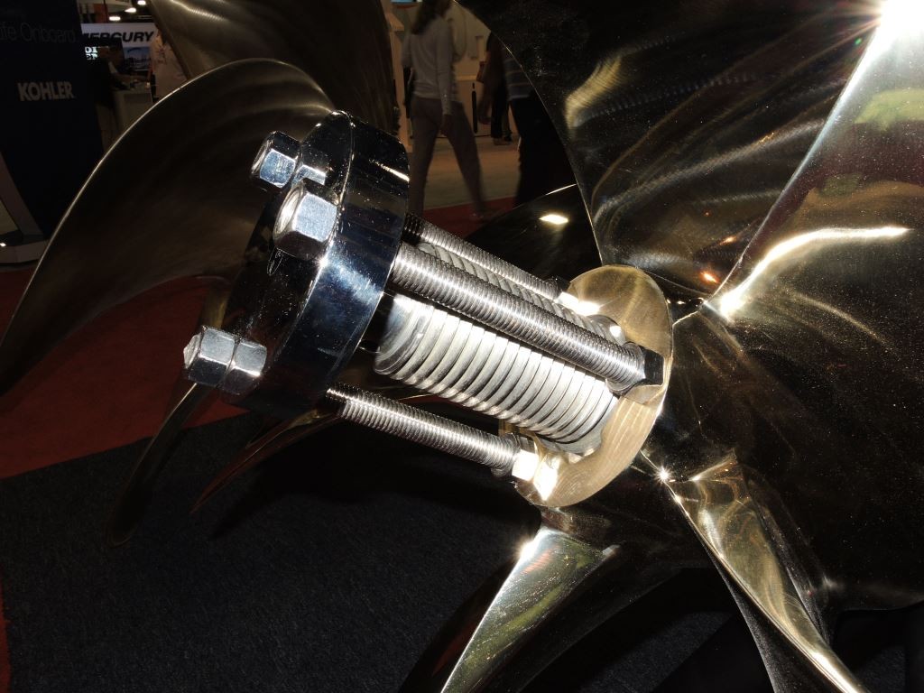

You shouldn't thump props with anything, to remove props it is better to jack them off. drill and tap two threaded holes in rear of prop put longs studs in and then get a steel stiff bar across these with a threaded hole in the centre. Wind up the pusher onto the shaft and you have full control with no chance of damage to blades or the puller slipping. This page shows a nice example at the bottom of the page using a ring, but two holes and a bar works the same, just don't have a picture handy.
http://stevedmarineconsulting.com/proper-propeller-removal/

BTW I made a prop puller like this so no need to drill and tap the boss of the prop.
