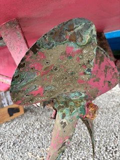

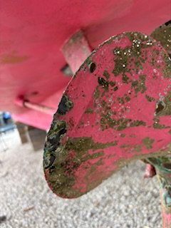

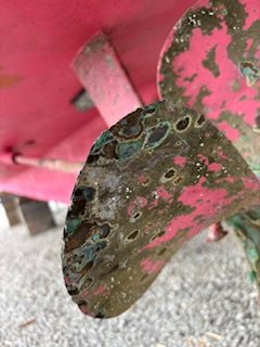

Thank you.It is all a little complex if you haven't looked into it. Basically it is to do with the dissimilar metals and a big lump of steel near to a metal such as props and some through hulls are made from will eat them, if they are not protected by suitable anodes.Also, if the steel hulled boat has any current leakage (especially , but not necessarily, DC) to the Hull (Earth) this will also cause problems. There are two problems that can occur, Cathodic (Dissimilar metals) and electrolysis which is caused by the current leakage in association with dissimilar metals.
The above is a very basic and simple explanation. No doubt the experts will come along and rip all the above to pieces. If you do a search for Cathodic protection and Electrolysis you will find lots of info. Have a couple of paracetamol handy as well as a good hour or four free.![]()
