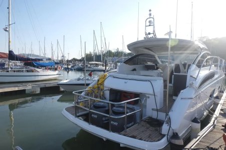

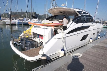

I came across a 2015 Princess V39 listed for sale on YachtWorld, equipped with 2x250hp Yamaha outboards. Maybe I don’t get out much, but I’ve never seen this setup before. I was thinking about emailing the broker just to learn the story behind it as well as performance, but I don’t want to bother them since I'm really not in the market! Thought some of you on the forum might find it interesting.

It looks to me like a lot of the headlining in the salon has been replaced, and I think I've noticed other signs of corrosion here and there. I wonder if the boat might have been in an accident and possibly even partially submerged at some point, which could have led to the engine replacement. Of course, this is purely speculation! The ad doesn’t mention anything of the sort - in fact, it claims the boat is in "beautiful condition".

That boat looks like a bodge on a substantial scale.

The installation appears to be quite neat but on a boat not designed for outboards and with what appears to be insufficient power it doesn’t appear to be a great concept.

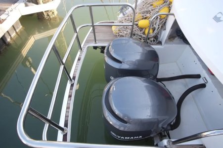

The engines seem to be mounted a lot further back than I would have expected.
In principle, that's not a bad thing, with outboards.
In fact, I even wonder why they made that Heath Robinson-esque platform modification.
IMHO, an extended bracket, possibly with a powerlift, leaving only the two side platforms - which in fact is all that can be used anyway, also in this solution - would have made been simpler and more efficient.
it looks like all interior wood furniture had been repainted. terrible.
based on my experience with the D6 330, those 2x250hp Yamaha are more than underpowered.
I do not understand what are those black boxes in place of the volvo engines.
only one tank used for both engines, they are not going much far away
