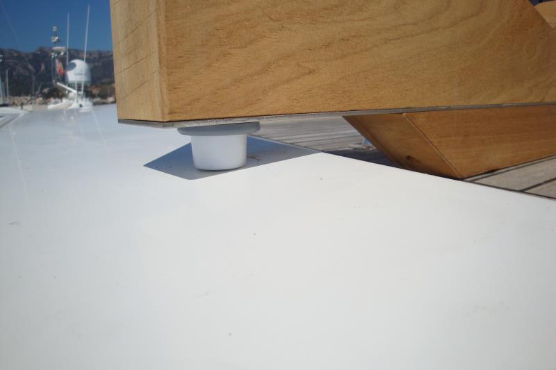

I made the chocks myself.
Not that difficult to do.
The best but more difficult way is to get the tender's hull profile from the dinghy manufacturer.
But you could make up some templates by cutting cardboard to fit.
I bought some nice bits of teak from a timber yard and transferred the profile from my templates to the wood.
Then found a local carpenter/joiner with a bandsaw who cut the teak into the shapes that I wanted.
My chocks are a little more complicated because I had to allow for an overhang over the flybridge edge - GRP moulding:-
I also made some changes to the profile by adding an extra "V" on the aft edge before cutting the teak.
I was very worried that it would be difficult to locate the tender onto the chock past the crane on the flybridge.
The idea was that we could "rest" the tender on aft "V" before finally seating the tender in place.
This process has proved unnecessary but it is great for cleaning/accessing the underside of the tender.

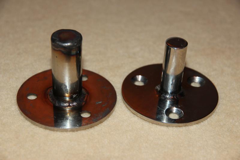

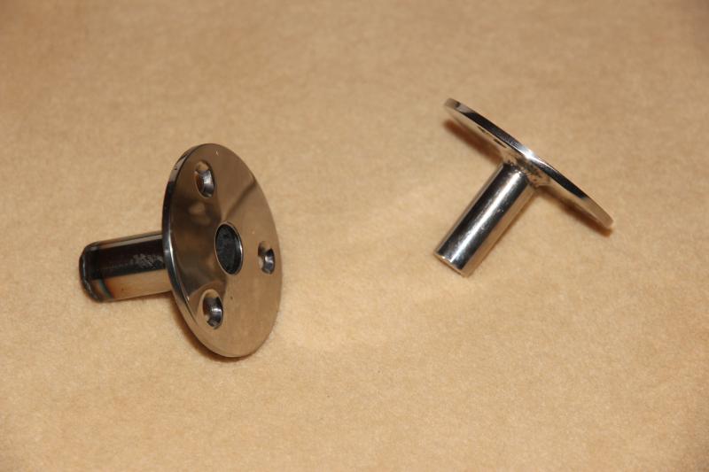

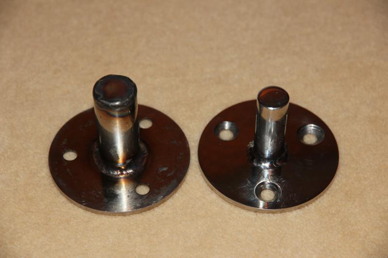

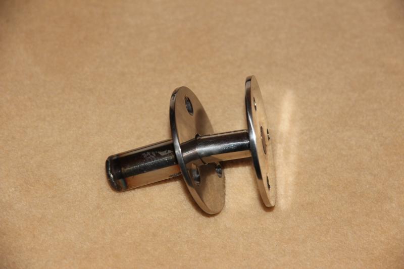

I have also found a few more photos of the socket and pin fittings.
You probably won't find them available anywhere.
I had to have some made by a local stainless steel fabricator.
