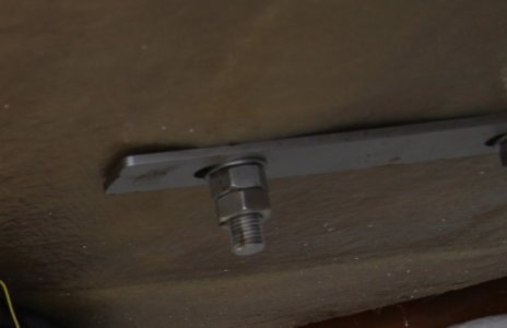

These are the ones on my P67 - I would have thought that the Y72 would use the same ones.
I've always thought that they are fabricated in the Princess factory - but I might be wrong.

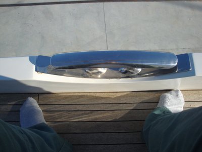

This is a photo of the same style/size of cleats that are fitted to our foredeck - the bolts are bigger than 10mm
Yes it is that style , you maybe right about bolt size , I would have expected a bigger spread plate . I think the problem is the 72 is very high from the jetty so the tension is a tight angle down so could explain why bolt snapped.
