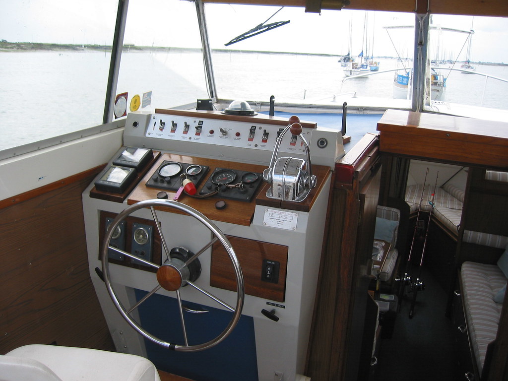

My first boat was a Princess 32. That said, there'll be so many differences between models and so many things changed by owners over the years that previous ownership will have limited value.
2) Possibly for raising/lowering the stern drives.
3) as above, pictures would be a great help.

First picture of mine when i purchased it:
Second picture of the refurbished helm, you can clearly see the parts, point #1 in the OP, which are for raising and lowering the leg.

Thanks all. The photos I've taken with the trusty iPhone are too large to upload, seemingly. A very attractive interior there though, surprising how much a facelift it creates. Mine is currently a bright red leatherette but plans to change for some 6mm perspex sheet.
My double circular discs do look like they should house two hour clocks, my 'singular' clock is however sat further up. Guess the switches on the same were to illuminate the clocks.
