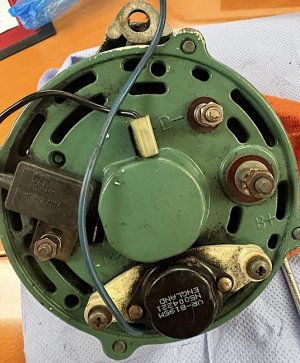

This is a Prestolite alternator (no model/part number visible) from a friend’s MD22L engine.
There is no terminal labelled D+, but there is a D-. The only mention of D- I can find anywhere says “In some systems, particularly older marine or industrial units, the regulator might have an "E" or "D-" terminal to ground the regulator”. In the pic I’m guessing that D- is the black wire going to a spade terminal and D+ (charge indicator) is the stud terminal to its right?
The boat has an Adverc Battery Controller fitted so I’m guessing the green wire coming out of the regulator is to allow the Adverc to control the field current.

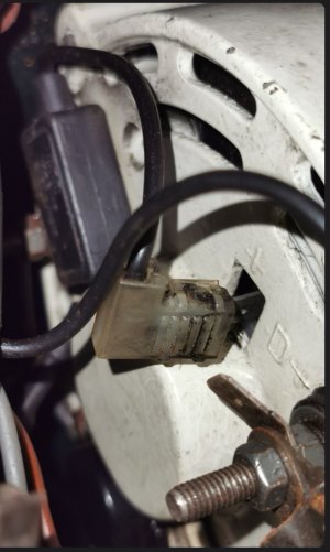

Colour blind? I can see no green wire, only blue and black.

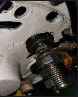

I remember having difficulty as what looked like D- actually turned out to be D+ when looked at more carefully from a different angle 🤬.

Give it a wipe/clean, try lighting it from a different angle.

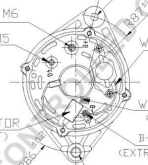

Check with the diagram too.

If you can find the prestolite part number you might be able to get the specific diagram for your alternator.
If you google "prestolite alternator diagram" you'll get pics of several different types. Just try and find a match for the layout of yours.
You really do want to wire the connections correctly
Give it a wipe, try lighting it from a different angle.

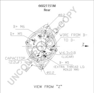

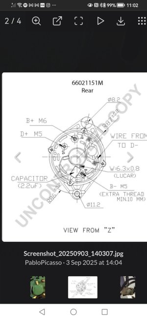

We have pictures from before everything was disconnected so can reconnect as-was, I was just curious as o why it has a D- on it. The rear pic of 66021151M says “wire from B- to D-“ just to add a bit of confusion.
We took the alternator off as it has stopped working, turns out it was just worn out brushes. We could have checked/fixed that just by removing the regulator instead of first wrestling the whole unit and its bracket off the engine (not possible to get the long bolt that it pivots on out without taking the bracket off). Hey ho.

Yes, very curious. Was it just poor casting? Or is it a D-?
You could ask the people who tested it
I think it’s just a poor casting as otherwise it is identical to the pic in post #4. I will be briefly reunited with it on Tuesday to refit it, but let’s just say that the owner is dead chuffed that it cost £34+VAT to repair and test.
