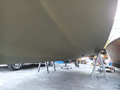

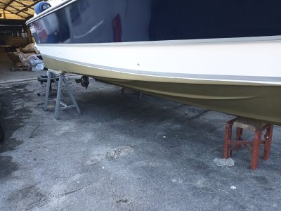

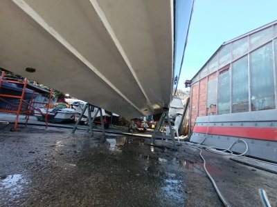

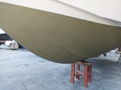

I have been offered a boat to buy and was wondering what i should look out for ? Is there anything obvious in these photos? i am very knowledgeable on classic cars (metal) having owned them for 15 years but boats, no idea at all!!!!! lol My impression is its impossible to tell the state of an engine, exhaust unless you pull it to bits so i will have someone look at that separately.

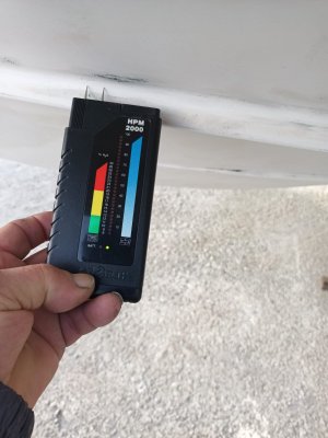

Any basic advice gratefully received. Heres the hull 2010 boat, after antifouling in 2021 i believe....I have not idea why you would put what appears to be a damp meter on a hull... Thank you.... (and we all have to start somewhere, im right at the beginning as you can probably tell!lol)

Those "damp meters" don't measure damp, they measure electrical continuity and are usually favoured by home damp repair scammers.
Probably only accurate measuring logs for your fire.

So many questions! Would be good to understand the boat make / model / engines etc and the asking price PLUS what you hope to do with the boat, before giving any well considered advice. For example, depending on value you might want a hull survey to ensure there are no structural issues or osmosis (water migrating into the layup of the hull) etc., etc.
Can't really tell anything from those photos, what boat is it, what engines and drives, how many hours on them, is there a stack of paper work showing regular servicing in accordance with manufacturer recommendations, and how much do they want for it?

First ask what the meter is about , ask about the filler on the hull , post some photos of engine interior and out drive cockpit etc.
Where are you seeing filler in those photos? Is it the grey marks on the photo with the damp meter in it? Maybe it's filler, but could justbe marks on the gel coat from scraping/blasting the old antifoul off.
Looking along the chine it looks lumpy , it could be me.
