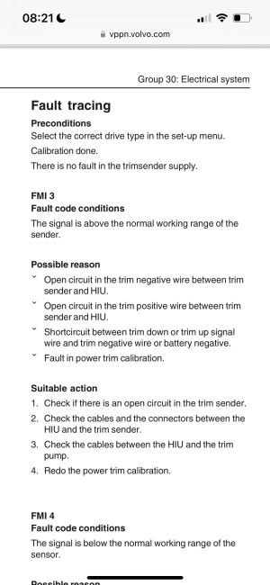

I have a Volvo Penta D3 190. I have a constant ECV error message relating to the power trim. I have replaced the sender at the leg and the entire cable from the leg to the control unit. However the message has not gone away. The power trim works fine and the leg goes up and down but the gauge doesn't read correct. The error code is MID 140 PPID 290 FM1 3. Any suggestions would be welcome.
