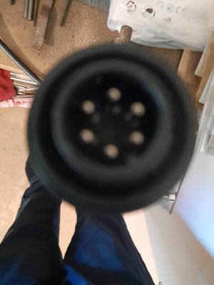

I am going to advertise my Autohelm 2000+ for sale but need to check that it is in working order. Does anyone know which of the 6 pins on the plug are the pos and neg please? I don't want to put the power leads on the wrong pins!
thanks for any help. Geoff

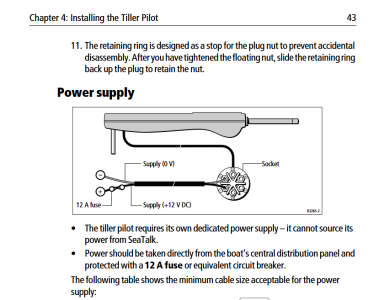

OK . Just pulled out my spare plug and my magnifying glass.
Looking at the back (screw terminal side) with the locating tab (which is on the pin side) at 12 o'clock.
2 is one o'clock Negative
and 1 is 2 o'clock Positive
They are actually numbered, but you will need a magnifying glass to make it out.
Typical Raymarine thoughtfulness.
gary
