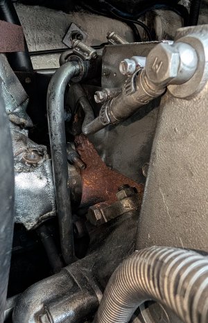

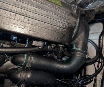

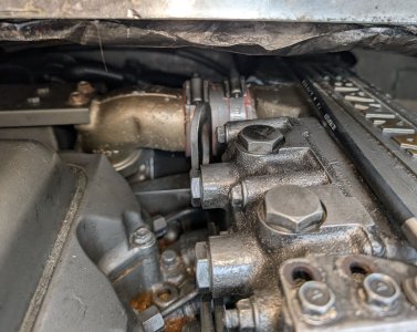

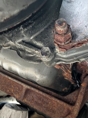

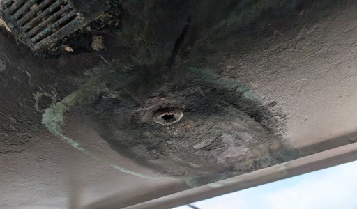

Hi everyone, new to the forum. Having read lots of useful articles here to get started, I recently went to view a 27ft Monteray with a diesel yanmar 6-315hp and there are a few concerning issues, which, though I am handy on the tools, I'm looking for something to enjoy some downtime on, not another full time job, what would you good folk think re costs to fix these issues...
1. Thru hull looks nok? 1inch of water entered the bilge after we dropped the boat in the water, and did a sea trial. Could be just loose/freeze damaged joints in the heads feed?
2. Water pump leak? Rust around base
3. Turbo failed? 3800rpm gave 19knts max. Interesting that it looks like a connection is missing from the top in attached photo.
22pitch prop on a bravo1x drive with 1:1.65 ratio. Boat is 3 tonnes (manuf figures)
Very little if any smoke. Ran up fine, just with no real power.
4. Usual small leaks from coolant pipe ends (20year old yanmar) evident at the exhaust elbow, and on the cooler ends.
Is it something worth getting into? Thanks all.

At that age you need to check the transom shield where the steering arm enters the engine room, they are prone to leak here as water runs in under the steering arm and eventually requires a whole new transom shield
How to eliminate 50% of the causes of the unwanted water.
The Taste Test. Salt or fresh (ish) all at your own risk of course.👅
Fresh. Possibly a leaking fresh water system or rainwater/condensation pooling due to water draining back due to boat being underway.
Fresh. But with a destinctive taste and smell of anti- freeze usually an interesting tint of pink,might be a simple as hoses or something more complicated and expensive, an internal boat problem and probably mendable with boat in water
Salt.
Raw water engine cooling, possible again hoses, or more worryingly the system itself including the various heat exchangers (oil/ main heat exchanger/ after coolers etc) and exhaust risers, all guaranteed to corrode over time.
If outdrives, possible leaks via the rubber bits supposed to keep water out of the boat, this will require the boat out of the water to be fixed.
Worst of all. Leaks around the transom assembly to transom joint.
If caught early enough remove and reseal, if not ,could involve considerable time and expence to replace or rebuild the stern of the boat.
Usually a decent torch and a the Mk1 eyeball will trace the source of the water.
It's got the wrong prop on it. Should be getting a far higher figure (circa 30 knots) at 3,800rpm. It's like trying to max a car in third gear, it does the max revs but not the max speed (or anywhere near).

During the sea trial, it was a smooth acceleration, but with no discernable boost, and lacking power all though the revs, as though it was putting out 150hp not 300+. And the fact the current owner has down pitched to a 22 suggests that was their solution to the deterioration of power, rather than addressing the root cause, although there was very little smoke, so perhaps it could be a fuelling restriction?
I'd be surprised if there's a turbo issue if the engine can still pull 3800 RPM in gear/under load? When the 6LP turbo on my 9m Ribtec popped it wouldn't go above ~2000RPM in gear. The coolant "leaks" don't look particularly fresh, more that some has leaked out during servicing and not been tidied up promptly? As above, I'd want to check the outdrive carefully having rebuilt the transom shield on my Bravo 3X - very common to get play in the OEM gimbal ring/tiller arm, rusted gimbal bearing, leaking gear/drive bellows, worn out clutch cones, etc., all of which can be very expensive to put right, even doing the labour yourself.
