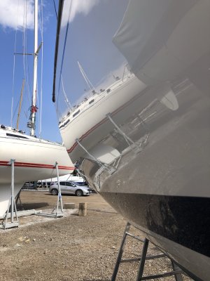

I have been using Koch Chemie products on my cars for a few years and tried their marine products last year. I found the one coat much easier to apply and polish out than 3M and when I first started "detailing" was surprised to learn that the recommended foam pads work much better than wool for buffing out.
Gelcoat One Cut
They generally recommend the pad colour that matches the colour on the bottle. A quick buff with a microfibre cloth to remove any bits you missed and the result is pretty impressive. Several people commented how our 9 year old boat looked like a new one.

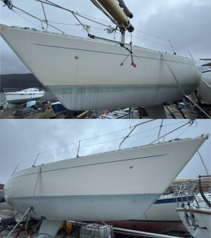

I spent Saturday on the ladder doing the Stb side with the Oxalic and then T-Cut on a rotary wool pad, but there are still some vertical streaks. Will see if the One cut and foam are better. (and then the polish to seal it)
