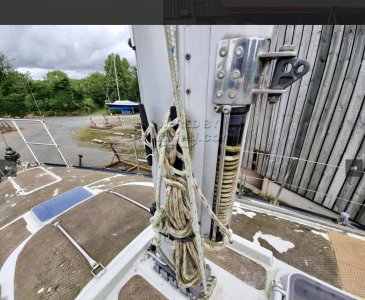

Hi all, the Dufour 2800 sailing boat I’ve purchased comes with a in mast furling system. i’ve no experience of using one nor even of bending on the sail and running the lines correctly. The lines, halyards, outhaul and reefing lines are removed and replaced with mouses (mice). The blocks, sheets, slidey things are all present but need assembling. The previous owner passed away 4 years ago so I’ve no one to ask for help.
I believed the mast was replaced in 2012 but I’ve just heard from Selden and they confitm although the mast is theirs the furling system iisn’t theirs. ’d like to identify which make/model it is so I can try to find a user manual for it. I’m not on the boat until next week and only have a single photo of the reefing gear at the base of the mast plus another of the boat sailing with the original owner at the helm.
Any help identifying the system fro so few clues would be really appreciated.

Looks like an Easyreef behind mast retro fit.
We had one on our Konsort for 12 years. Once you have it set up right and learn how to use it properly, it's very simple and easy to use. We liked it a lot (but we were already in-mast converts) Lots of people will tell you to junk it. I would not be one of them.
Lots of things you need to get right before you will enjoy owning the system.
I'd start by removing the reefing line and giving it a good wash as it looks stiff and green. Log how many turns it has on the drum before you remove it.
Some tips...
Before hoisting the main... apply a silicone spray grease to upper halyard swivel and make sure it spins freely. Same with lower furling drum.
When you hoist the mainsail, do not over tighten the halyard... you do not want to too have any tension in the luff, the sail luff might have some small wrinkles, that's fine, the mast wants to be straight, no rake.
With the mainsail hoisted and the main sheet loose, set the vang to stop the boom rising when it comes to furling the sail, you are generally looking for the boom to be about right angles to the mast, but this depends on the cut of the foot on the main (our boom was a little higher than 90 degrees because our foot was cut at an angle to spread the furl within the mast)
Now tighten the mainsheet hard and set the topping lift.
Now to the furling bit...
This is always best done with the wind just off (about 15-20 degrees) to starboard as it keeps a bit of tension on the sail to enable a neat furl.
RELEASE the mainsheet, you do not want any tension in it.
Keep some tension on the outhaul while you pull the reefing line to furl away the main. I used the reefing line on a coach roof self tailing winch with one hand as the other hand kept tension on the outhaul.
TOP TIP: Most people get the dreaded 'jam' while unfurling the main. It's usually because the sail is too loosely furled in the mast when it was put away (although a tired, baggy and out of shape mainsail can also cause a jam - if so, it will need a re-cut )
So... to avoid this:
Once the sail is furled, lock off the outhaul on a cleat or jammer and then continue to winch or pull in the reefing line for a further half turn of the furling drum. This tightens the main nicely on itself (like you would on a roll of wrapping paper) which means it will unfurl nicely next time.

Hi Moonbeam, thanks for taking the time to explain all this, it’s exactly what I needed and most helpful. Yes, I’ve now searched on the internet for Easyreef and believe you’re correct. Will now do a search of YouTube plus these forums as you suggest. ATB. Brian.

Yes, that looks like the Easyreef system although more detailed photos would be needed for me to be absolutely sure. In any case, Moonbeams tips are spot on for avoiding in-mast furling problems.
I have not been able to source a Easyreef manual or diagrams for maintenance, as they have been out of business for a number of years. But if you do attempt maintenance, a word of warning: when loosening the nuts holding the drums in place - the bearings can drop out and will typically make a beeline for the scuppers. Best to set a bucket or container below the drum. A good greasing did make for better handling though.
Also tightening/loosening the nut underneath the drum will adjust the tension on the furling spindle - getting the 'right' (not too tight, not too loose - test it in harbour) tension makes for better furling and less chance of jams. Tightening the nut also prevents the annoying clanking of the spindle inside the mast if you've removed the sail (over winter for example).

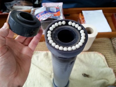

Yes, I found that the first time I removed the drum... the second time I did it, I realised I could leave the stainless steel fairlead bar (that keeps the reefing line furling nicely) bolted to the top and bottom bearing on the drum which helped keep it together when removing... still have to be careful mind you as the bar only holds one side and the bearings can still slip out, but made reinstalling easier! The reason for removal of our furling drum was the centre drum was grinding on the lower bearing... years of use had worn a rut in the lower bearing and the delrin ball bearings were in the rut. Solved by adding a thin washer to cover the rut.
