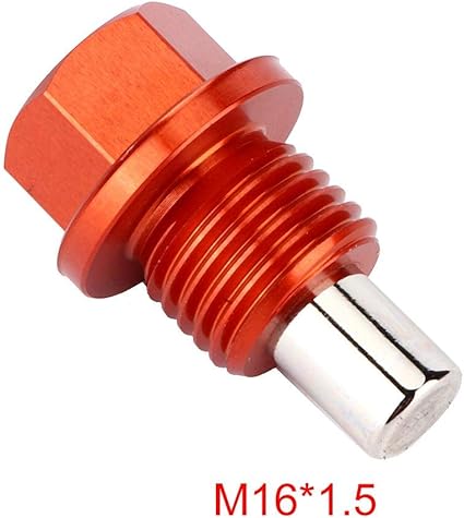

I think the solution is to just buy a replacement that isn't specifically designed for the engine, but one that has the same thread. So, I was thinking of an M16 x 1.5 like this one from Amazon:
Is there anything I should watch out for - such as the fact this is not plastic/nylon!?
I'd be a bit wary of mixing titanium with aluminium. There's a big difference in their galvanic potentials. Ti might be a worse choice than stainless steel.

On the other hand the drain plugs on aluminium outdrives and on my outboard are stainless steel and nothing bad happens.
