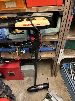

We have a trolling motor which only seems to be good for getting you home if there's no wind. But we have an epropulsion spirit that is pretty good for pushing into a reasonable headwind (we found out today) not that we've used it that much. For info the trolling motor is a pig to load through the well but can be done - much easier to load it from underneath when ashore; not helpful if you are already on the water.

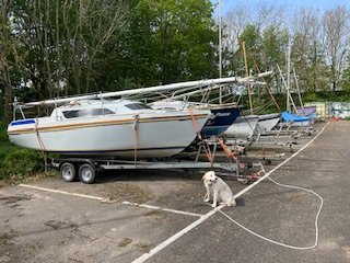

I’ll get some photos of the trailer modification and post a link to the suppliers of bits. Grace will be at Whitwell for the winter. I can still sail some days all year I think. Winter jobs include repainting the non slip deck bits. Trying to straighten a slight kink in the mast. Replacing the keel lifting line as a precaution and lowering cleaning and repainting the keel. The latter will involve moving the boat back on the trailer and jacking the whole trailer up about a metre to gain sufficient clearance. I will probably need some scaffolding to support it all before working underneath. Photo of boat and electric outboard. Minn Kota 56lb thrust. Good enough for about 2kn in still air!!

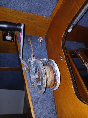

The keel winch ‘jumped’ on mine last time I raised it. The problem seems to be that the winch drum is not aligned to the pulley which feeds the rope on. The result is that the line piles up on the aftmost side of the drum then slips off. I will look into re aligning it. The table is removable. It just sits on a tapered leg set in the floor. Might be a bit tight/ corroded but they do pull out. Mine had a small metal tab holding it against the keel box.

Gawd knows what the shenanigans will be when it comes to trying out the drop keel on mine - the winch and raising warp do seem a little worse for wear, even though the 'wear' was simply sitting in the previous owner's back yard for 12 or 13 years doing nothing...
It's a good job she's still on the trailer! I'd be having visions of the keel heading down to the deep if I was looking to lower it using that lot! Anyone got pictures of what it 'should' look like? :) (so I can sleep tonight)
To be fair, I think it is just a bit of surface rust and that the rope has become stained with the erm 'humidity' that was standing in the bottom of the boat for a good few years. I'd be interested in your thoughts though!
Because most of those winches are used for non yachting purposes you can buy new ones for trivial amounts of money from non nautical suppliers. Low rech polyester ropes are also v cheap. Not worth messing about.

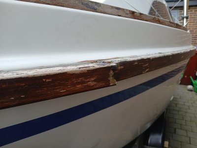

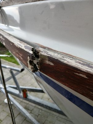

Ok, so today's conundrum has two parts, and is about the rubbing strake along the port side of the boat, going aft.
As you can see from the below, part 1 of the problem is that due to being stood exposed to weathering for many years without maintenance, the rubbing strake has rotted and split forward of the waist of the boat. The wood 1cm either side of the split is good (solid with no apparent rot) and will clean up for a re-varnish in the same way that the starboard side strake has done. I am not entirely sure how to go about effecting a repair, so any advice and guidance would be greatly appreciated :)
And from the other side:

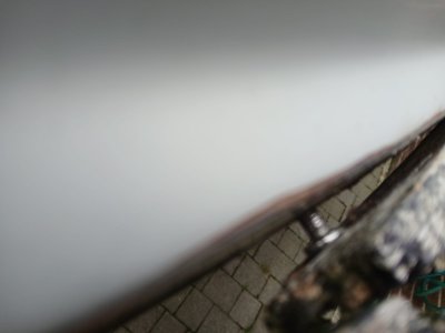

Part 2 of the conundrum is that the fixing (flat-head bolt with internal nut) just seems to spin around in the recess, and doesn't seem to want to come out. Has anyone else any knowledge of what the internal arrangement is behind the rubbing strake, for the bolts to secure to? I'll persevere with all manner of jiggery pokery to try to get the bolt out, but am concerned that I don't know how it might be replaced, depending on how the bolts fit to the hull. Again your wisdom, experience, insights and suggestions are all welcome! (My apologies for the slightly fuzzy image below).
My own thoughts were to try to repair the existing rubbing strake by letting in a piece of timber, rather than going the whole hog and replacing the lot. Having said that, if I were to replace the whole rubbing strake and kick plates (which to be honest have seen better days) what would YOU use or suggest? I do have to replace the short piece from the back of the boat, which had given up the ghost long before I took the boat on...
Thoughts? Ideas? Jokes at my expense? C'mon, I know you know you want to say something :)

I expect that you'll find the rot goes further than you think, but scarf jointing a new piece in shouldn't be too difficult.
As for the bolt, is it a coach bolt with a square bit under the head?
shopping
That bit locks it into the wood to prevent turning and, when the wood deteriorates, stops gripping it, so it spins freely. If you can get a spanner on the nut inside, a pair of Mole grips on the outside might do the job, otherwise, it's bolt cutters or an angle grinder.
Hello Stemar,
Thanks for the reply - the bolt is a flat headed stainless steel one, slotted for a flat screwdriver. It is just spinning and loose in the hull but appears to be connected to something (a nut perhaps?) as it won't slide out of the hole, even with a persuader underneath the head. I'm leaning towards the angle grinder approach and yes, a scarf joint should do the trick, with the strake either side secured with stainless self-tapping screws into the hull.
I'm going to measure up and price a full replacement, probably going the synthetic approach for ease of maintenance, even though I think a pretty boat like the Pippin 20 deserves to keep her traditional look.
