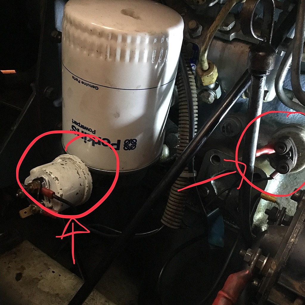

Here both electric, on filter head and engine block

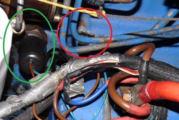

Here both on engine block, one electric (green) and one mechanical (red circle) a hose to a gauge
