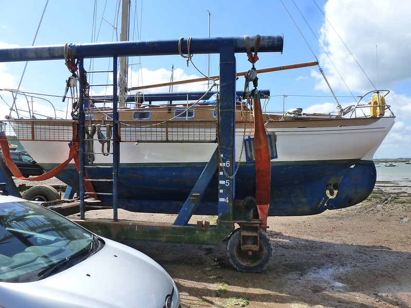

Update (have I achieved 99% boredom on the thread yet?)
P1040190 by Roger Gaspar, on Flickr
TG pulled out today. Too windy for now to varnish today anyway. Just waiting for her to be moved and chocked: then check over seams, prime bottom, flat down topsides, undercoat topsides, prime bottom again, gloss topsides, first coat AF, re-paint the cove line, second coat AF - back into the water. Today's report - Rudder heel bearing still fine - no evidence of any excessive wear (it's a constant issue; the pintle effectively grinds away at the socket of the heel in a fine grinding paste aka silty water), cutless bearing fine. The high pressure has found out quite a lot of lifting A/F and primer - best to find the bare spots but all the planks absolutely fine. Nothing to worry.

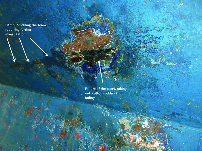

Let me achieve the ECF's peak for boredom i.e. 100%. Bit of a drift:
For the last 3 years there has been a small leak aft port, low down right by the engine bearer. Makes about a litre in a fortnight. But difficult to find. But solved! I feel sorry for you plastic boat owners - worrying about your osmosis. MAB - simples. When the yard chocks you slightly aft, the bead of moisture au bilge (technical MAB term) will expose the leaky seam dead simples. Find the damp and go poking (its behind the aft strop at the image above:
P1040198a by Roger Gaspar, on Flickr
Having exposed the leak, then raking forward and aft until the stopping is rock hard and the cotton underneath is dry - (below in progress, bilge still with bead of moisture au bilge - you can still see tis dripping!):
P1040200a by Roger Gaspar, on Flickr
I didn't take a final image but will do in the morning to ultra boredom. Now if you had a problem with the bottom of a plastic boat - 'tish - lots to do. MAB dead simple:
1. dry out the bilge (otherwise the seam will stay wet until it drains out. Not really very technical; :rolleyes:
2. let the exposed seam dry. Not really very technical; :sleeping:
3. once dry, prime in the seam. Not really very technical; :p
4. hammer in some cotton. Not really very technical;
5. now technical - some say now prime the cotton once firmed up in the seam: others say don't. Very technical; :confused::confused:
6. now mix up some red lead putty. Not very technical; :p
7. wop (technical term) the putty in the seam. Not very technical; :)
8. now prime the outside of the seam, AF, AF, launch. Not very technical. :cool:
Can you see the logic of having a MAB? Once I am afloat I can lift up the floor boards and gaze on the bilges, exuding the pleasure and pride of having a dry bilge. :encouragement:
