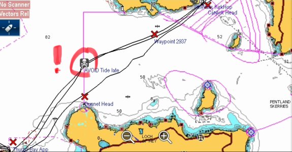

Well, after studying the Admiralty Tidal Stream Atlas I came to the conclusion that CCC was right and there was basically no way to time the tides right from Scrabster to get round Old Head and turn north in one tide. So need to head into Scapa Flow instead.
However, I am not sure where CCC considers “mid-Chanel” from Scrabster, but I seem to have found a rather dangerous spot where the tide still runs West at 2 knots - an hour after it should according to the tide tables have turned East. This is 3 miles due north of Dunnet Head light, close to the K tidal diamond on an Imray chart. West going tide and Atlantic swell from the west are clearly not a happy combination, hence why one tries to time this trip very carefully.
The first time I did Scrabster to Scapa I stuck fairly low in Thurso Bay to benefit from the early tide East, but found waves got up within 3/4 of a mile of Dunnet Head light- nothing serious but rolly.
So last two times I tried to leave a bit more distance from Dunnet Head to keep away from a lee shore in NW waves - and not wanting to be swept past Cantick Head entrance. So had a waypoint 3 miles off Dunnet Head.
I had forgotten that last year I suddenly found a bit of adverse tide West going tide there when should have been going East for an hour - was relatively benign weather so sudden wave build up was not a major concern in a seaworthy boat.
This time in stronger winds had been doing 8 knots SOG downwind and down tide (6 knots + 2 tide) with bigger but benign waves, when suddenly things started to get more menacing. Big beasts all round. Looked at chart plotter and noticed was suddenly 4 knots SOG though speed through water still 6 knots - roughly same place as last time (which I had assumed was just an anomaly).
Biggest and most mixed waves I can recall (and I have crossed the Atlantic), but had already prepared with hatch boards in and harnesses on just in case. Unfurled full genoa to increase speed and with careful hand steering (and no waves actually breaking) we surfed further East as fast as possible.
10 minutes later we’re back in East going tide, and water was so flat (barely half a metre of ripples) that the coffee cups were not being spilt. Like a different planet a mile further East. But I will keep within a mile or so of Dunnet Head next time (or take the ferry!)
PS. another going to make same mistake next time so amended previous waypoint to remind me ….

Thanks for your comments - and for clarity, no criticism implied or intended for CCC Directions. They are brilliant and the indispensable "bible" for sailing in Scotland.
Having grown up racing slow dinghies in very fast tides, i am very familiar with the vagaries of Scottish tides - which often seen to rudely fail to read the tide tables.
Also very familiar with typical sources if tidal eddies, and have used to sail through places like Dorus Mor (regularly), Corryvreckan, Kyle Rhea etc against the nain tide using eddies - and caught a great one through Yell Sound earlier this week (thanks again CCC Directions!).
However the spot marked with skull and crossbones on my original track seems a very odd place to get a total tide reversal - in mid channel miles from any headlands or bays. Very odd - and borderline dangerous if caught out.
Going clockwise didn't appeal on the day as after brisk SW winds the swell was low near the North coast of Scotland - but predicted to be 4m off Hoy Sound. If was at all late there, or a tidal eddy or even reflected waves, a lee shore with tide starting to flow out of Hoy Sound would definitely spoil one's day. Indeed, even Hamnavoe seemed to agree and inbound aldo went via Scapa Flow
Enjoy your trip to Orkney and Shetland and already looking forward to next edition (though current 2nd Edition is still great, massive advance over 1st Edition).
