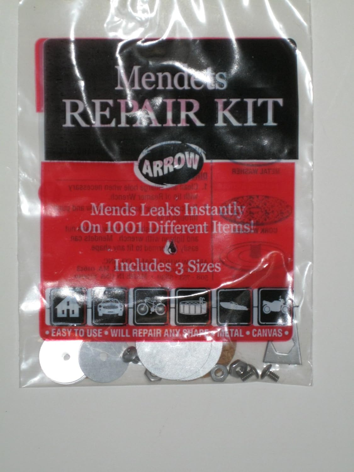

View attachment 85393View attachment 85394
These used to be available in any hardware shop
