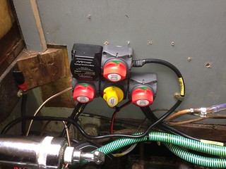

+1 This my twin engine setup. One house isolator (top), one for each engine and the yellow one parallels them all together. VSR top left to look after it all in day to day use.
