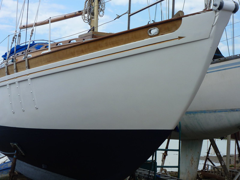

P1040211 by Roger Gaspar, on Flickr
Gold line is dead easy and dead cheap - Humbrol enamel or similar from B & Q - it sticks. First coat isn't great, second coat is not bad, third coat is like the above. All three coats can be put on in a day, no half a day, with 14 degrees or so of temp. Then:

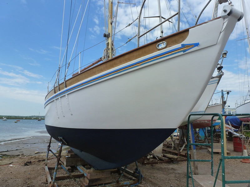

P1040218 by Roger Gaspar, on Flickr

This is my concave cove line painted in Acrylics as mentioned in my post #3:
