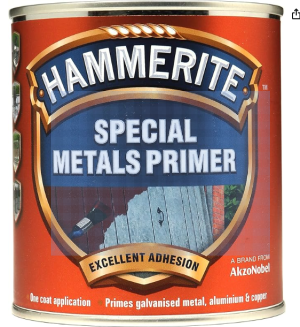

You need an etch primer for aluminium.
Not necessarily. We have powder coated alluminium window frames. Stripping mechanicaly, wire brush in a dremel to followASAP then use Hammerite 'All Metals Primer' followed by a spray or brushing enamel of your choice. One window frame done like this is in its sixth year, no further deteriation. The Hammerite may, of course, have an 'etch' element, but it is not clear from the contents.
Not necessary then the primer used may have an etch element. Not exactly a certain statement.
Normal primer may stick but companies have been spending extra for ages for a good reason.
The surface should be clean and free from corrosion to be spray painted.

I have posted many times about the excellent results achieved by Hammerite Special Metals primer. I have used it for years on aluminium, galvanised steel and copper alloys for propellers and P-bracket. A superb product that has never failed for me.
Specifically for aluminium I prepared a base for my radar scanner when living in the Netherlands, so well before 2003. Hammerite primer with their smooth product on top. It has never been retouched and looks almost as good as the day it was assembled on the boat.
