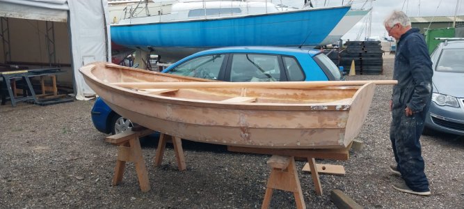

I'm close to finishing a 9' 6" version of the Woodenboat Nutshell design of pram dinghy. I will epoxy seal the boat inside and out, on the outside with woven glass material. Having done that - how do I paint it? Should I be looking at a primer then paint two pack polyurethene? I've looked (a bit) at the Jotun range of two pack paints but getting confused by the many alternatives they offer.

Very nice. From a protection point of view a simple one pot will do. A 2 pot is harder and will resist abrasion better and if done well will likely be cosmetically nicer. Just choose one system and follow the instructions. Personally I would use Toplac. 2 undercoats and 2 top coats. That is because I have always had good results so why use anything different?
