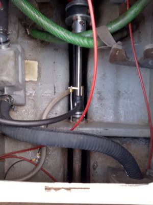

Everything below the waterline on my GH is finished in grey Danboline and although parts have been refreshed, the section iof the bilge in this photo is original from 1979. Danboline is still do popular and available because it is one of those products that performs as claimed.

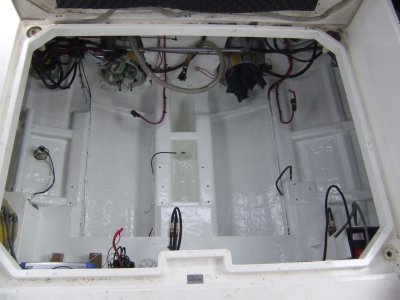

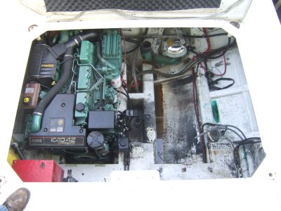

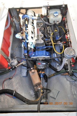

Danboline is fine but you must be rich, I used good old garage floor paint, greas proof, oil proof,water proof and much cheaper and also lasts for years, before and after 2 years later
