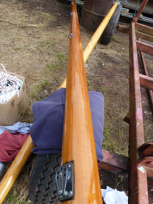

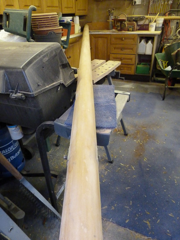

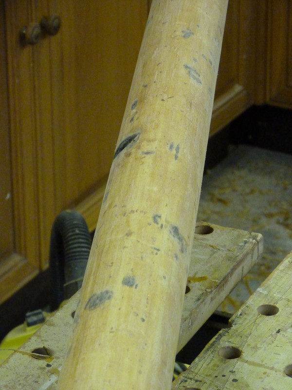

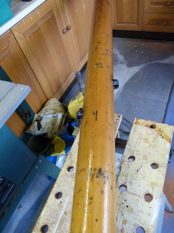

I have used oxalic acid on teak, iroko and spruce (spars). Depening on the extent of the marks you will need repeated acid application. And you will still need to sand down after the acid. Here is a series of images:
Before attention
Laying Up 2011 037 by Roger Gaspar, on Flickr
Varnish removed by hot air gun
Laying Up 2011 040 by Roger Gaspar, on Flickr

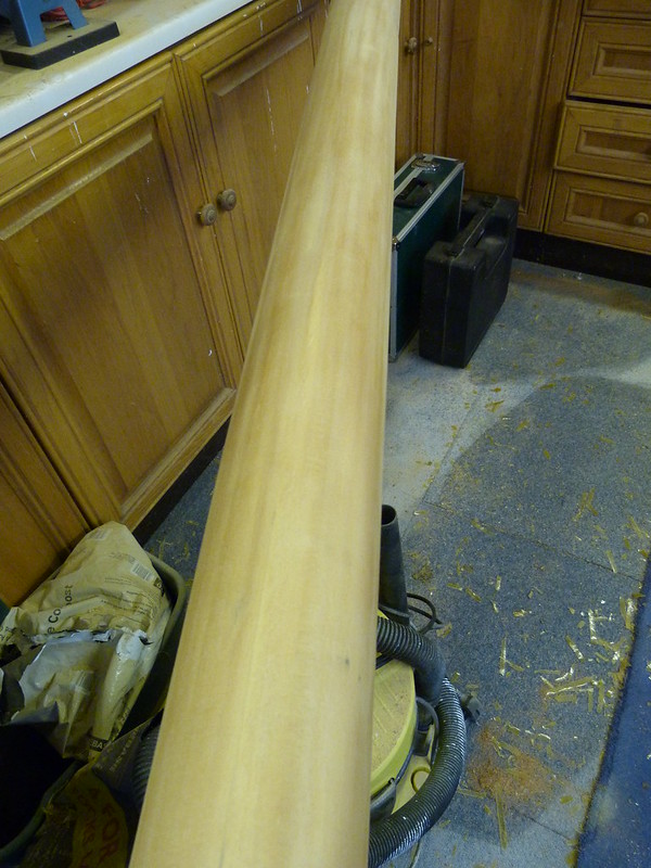

After repeated acid applications. I think it was 5 or 6 applications. I could have made a stronger mix but preferred to do little and often. Of course I had the option of turning the spar for applications.
Misc 2011 050 by Roger Gaspar, on Flickr
Sanded
Misc 2011 048 by Roger Gaspar, on Flickr
10 coats of Epifanes Clear Varnish
P1010094 by Roger Gaspar, on Flickr

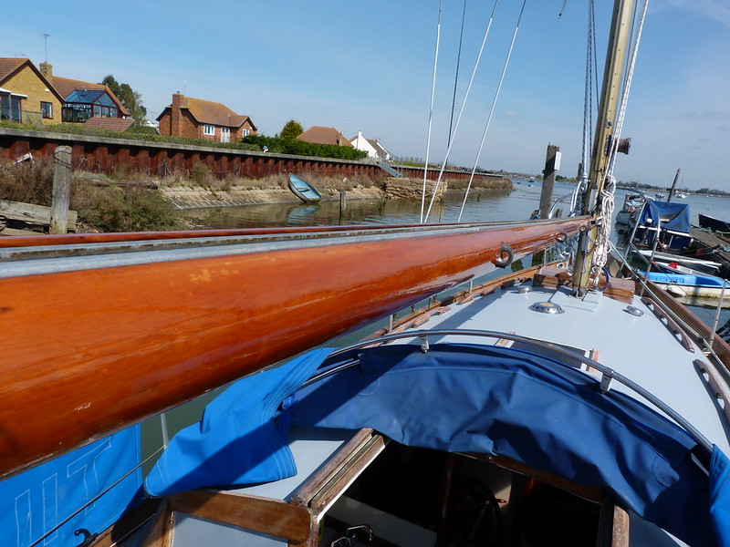

After 3 years of use. Note the spinny pole behind the boom
P1010059 by Roger Gaspar, on Flickr

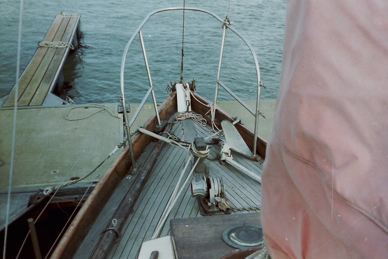

How the spinny pole was in 1991 when I bought the boat. All is possible.
DSC30254 by Roger Gaspar, on Flickr
Personally I would not use epoxy. Tried that once on the coachroof; nothing but an appalling finish. Epifanes Wood finish is designed for Teak and iroko. I used Epifanes Wood Finish on the cockpit (iroko) - excellent for that, tough, rapid application (ditto for the handrails). Touching up is good and easy. It isn't quite such a good finish as the proper varnish. Please, please cut out that epoxy nonsense (I hate it in that sort of application I admit). The 3 coats of Epifanes would be far, far better.
