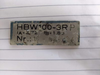

All i know is what is on the grubby plaque on the gearbox ... see attached pic ...
It says HBW100-3RP A=2.72 B=1.83

thanks ... but I'm not really clear what I'm asking them..... am I asking if the gearbox with that combination existed? Surely the plaque isn't wrong ?
And if the plaque is right ie a 2.72 reduction going forwards ... what would you calculate is the right size prop. Diameter would have to be 13 as I'm not sure a bigger one would fit.

Back to the original - with that reduction you need a 15" prop. Crudely if you add the diameter and pitch you get "size" as in the load it puts on the engine. so the 15*10 is 25. Go down to 13" diameter and you need 12" pitch.
Essentially whoever installed the engine did not understand what they were doing and specified the wrong gearbox - or more likely just bought what was on offer.
You can physically check the reduction by turning the engine manually in forward and observing the turns of the output flange or propeller. One turn of the engine should give 0.5 turns of the output for 2:1 or 0.37 for 2.72..
