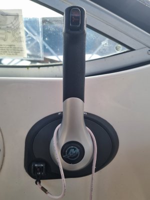

I can probably get to the switch connections if I take the throttle lever assembly apart. Is this tricky to do? I couldn't see any obvious fixings when I was having a play around with it earlier.
This is what mine looks like. Not a great pic I'm afraid.

If the leg trims right down normally and right up with the trailer switch, it might not be the limit switch on the leg. If the up button is intermittent, then it might just be the button itself. This happened to me on my commander 3000, which is the predecessor to your control. A new switch in the control solved the problem. This should be easy to test if you can take the control apart. I did eventually have to replace my sender and trim limit switch as they are prone to failing. I agree with Grubble. If it is both sender and trim switch, you can still get by until the next lift out. Your control is a Quicksilver 4000. A Google will get you everything you need.

I'll start with trying to get the switch out from the throttle assembly if that's possible to get at. I don't really want to lift her

If you join the Facebook Mercruiser Sterndrives group, the file section has a load of service manuals. There is a Remote Control service manual which covers your remote and provides guide and illustrations on how to remove the handle to get access to the switch.
