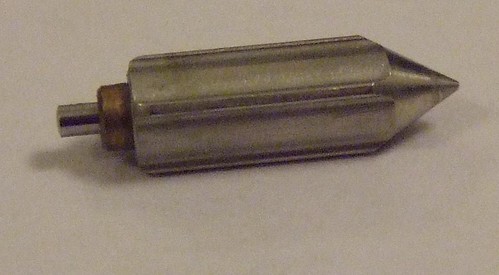

I've got a problematical outboard. Unfortunately I don't know the year, but I think it might be a '93.
Anyone got a manual that they'd be prepared to photocopy and send to me? Of course, I'd be happy to reimburse copying costs and postage. (a scan and email would be better!)
This little widgety thing fell out and I have no idea what it is. I've tried to post a picture, but not sure I've done it correctly.

That is the fuel float valve that allows fuel (or not) into the float chamber from the fuel supply. Which means you have had the carb apart at least. /forums/images/graemlins/grin.gif
You will find a little flap between the 2 floats, which is where this bit sits, pointing upward into the fuel supply inlet seating. Do not bend that flap, as it is set with the float level to meter the fuel flow into the chamber. You will prbably need to remove the long pin that goes through the posts in the carb underbody and through the floats.

Agree with what FullCircle said - it's a float needle valve.

Edit to add: The pointy end goes uppermost with the small, springy peg resting on the little flap on the float arm that FC mentioned.
