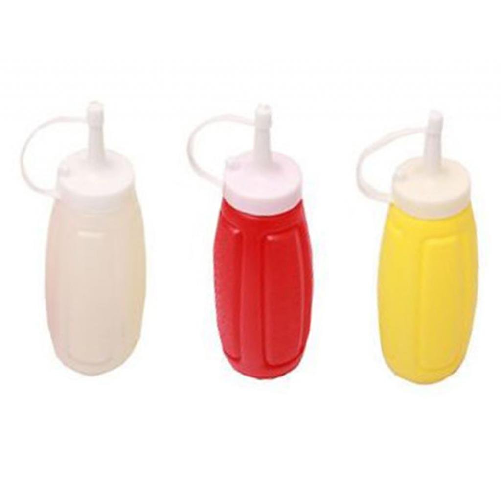

Personally I bought a squeezy bottle of oil with a tapered nozzle in the early days of owing an outboard and have been refilling and using that without problems ever since!
