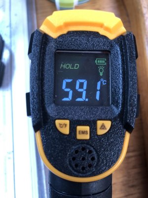

Simon, you could probably use 14v which is 3.5v per cell and will charge to lets say 99%. Just be aware there is a good reason for those large fins on the back. These things get hotter than the sun, so don't put it in a cabinet or under a bunk with no air circulation. Mine is on the outside of the nav seat with a 3" hole behind it. A small computer fan would be a good idea.

tnx Pete, fan good point and no prob to install
