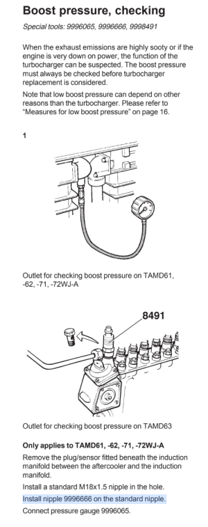

I want to measure the turbo pressure on my VP TAMD61A and found the original pressure gauge with the part number 9996065 in the workshop manual:
I could acquire one of these currently for around €200 but was wondering if anyone could recommend an equivalent cheaper make/ model? Do I rightfully assume that it doesn't have to be the original so as long as it's a decent pressure gauge?

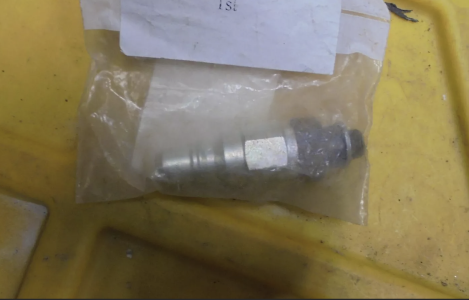

Also, if I understood correctly, in order to connect a pressure gauge to my TAMD61A I would need that nipple part with the number 9996666. Here's a picture I found online:
This would cost another €100. Same Q here: does it have to be the VP piece? Any recommendations for cheaper equivalents?
Lastly, if anyone happens to have either of these flying around for sale please do let me know
