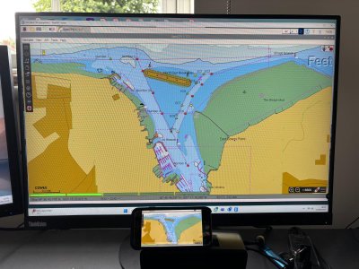

You can show the Openplotter screen, and indeed control it, on a phone/tablet easily. I user VNC. In the picture I'm using a Pi to drive a screen on my desk, my phone is at the bottom of the shot. I build them at home and for the boat use a 10" monitor. If you continue to use your laptop then you just access that the same way on your phone or whatever.
Edit: obviously the laptop solution is easier, more portable, for use in your case when you'll be hiring.
Edit #2 You can test it, install RealVNC server on the laptop, download Real VNC (RVNC Viewer) to your phone, click the + to add a new computer and type in the IP address of the laptop (Assuming phone and laptop are on the same network).

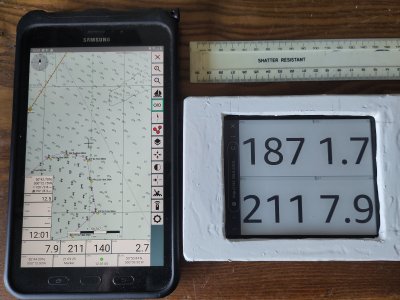

I use open source AvNav (a simpler, more friendly cousin of OpenPlotter) and have run it in the Android version or on a Raspberry pi (headless, server only). I use a waterproof e-ink Kindle paperwhite as the 'dashboard' display device (over WiFi). The charts are like those for OpenCPN - affordable UKHO vector data from O-charts.
More information here: AvNav and the Kindle Paperwhite - Segeln-Forum
