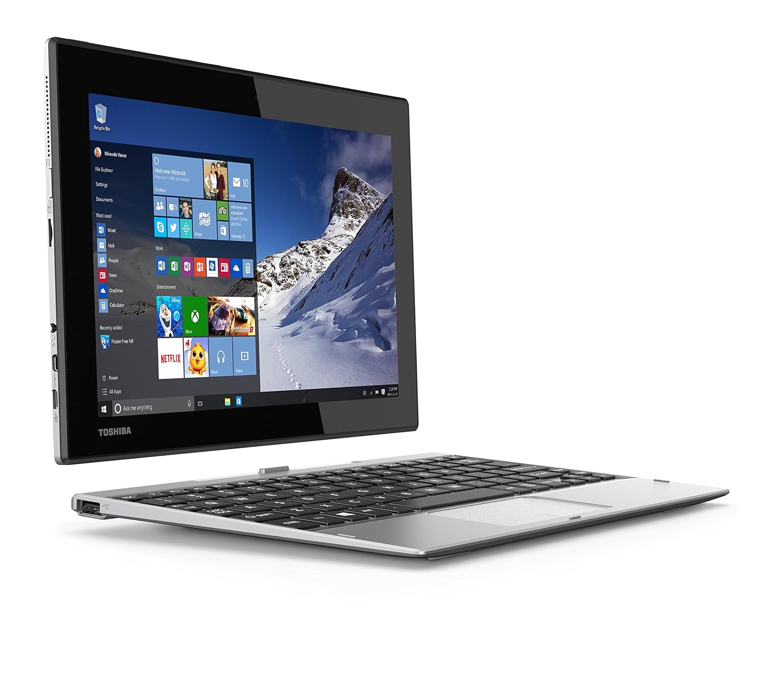

The current cockpit OpenCPN (there's another one running in parallel on a laptop at the nav station) is a Toshiba Satellite Click I got for cheap because it had a Spanish keyboard which nobody else in the UK wanted. That's a convertible or "rip-off", because you can rip the keyboard off (see below) and then have a tablet, but when you want to use keys and a touchpad (like when doing your passage plan) you can just click those back on. Mounted on the binnacle grabrail with a "Railblaza Starport" with tablet holder insert and USB charger. When it gets wet, a clear plastic bag goes over the whole shebang. Sunlight readability involves squinting or shading the display with one hand - I haven't found a good device to solve that problem yet. I tried a Panasonic CF-H1 Field for a while, which had a brighter display, but it was slow, big and clunky and had a useless resistive touchscreen.
The Toshiba currently runs Windows 10, because it seems to be the only desktop OS with acceptable touchscreen support. I'd much rather run Linux like on the laptop, but there's not even a properly working virtual keyboard there yet. Mobile OSes are out, because they're too restrictive and so are the apps on them, which leads to nothing but frustration.

We're still using the 10" Toshiba Windows tablet mentioned above. I have since DIY "ruggedized" it. This is surprisingly easy! If you look at most tablets, they're mostly already waterproof. The front is a continuous piece of glass, the back a continuous piece of plastic. Water can only get in at the edges where the two are joined, and the connectors. The only connector you need is the one supplying power. So I just took some 3M clear tape (the super strong stuff used for patching up sprayhood windows that boasts 6 months UV resistance) and taped it over the edges, with some creative solutions around the buttons to keep them functional. Squirt a bit of silicone grease into the USB charging port before plugging it in and water won't get in there either. We've used this in driving rain and spray so far and no signs of water ingress. We can no longer attach the optional keyboard, but haven't used it before either, so no loss. It's a bit ugly looking now, but I can live with that.
Screen readability turned out to be a non-issue as soon as we got into places where you have to sail with the bimini up anyways (or turn into a shriveled husk of cancerous skin).
There's also nice looking IP67 tablets of similar spec available from importers now, but they're around €500, while the Toshiba was much cheaper than that, so while that works we'll rather spend the money elsewhere.
It's still running Windows 10, but that doesn't really matter as long as you do not allow it to auto-update, which is where it usually shoots itself in the foot. Windows update servers are blocked at the router. It's a navigation device, not a entertainment one, so no websurfing and nothing much installed - you hardly interact with the OS at all.
