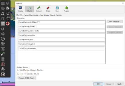

To get the charts first click the gear icon which will open up the options, then click o charts, chart files >
Click on add directory then go find where you stored the files. Then click the little box to select "scan charts and update database" and OK. Give it a minute and that should be it!

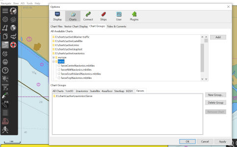

But it will be a mess!!!! Chart groups next, same place click on "chart groups", create a new group then double click on the directories in the top pane if you need to to find the area you want , click add and should be it, number keys on the keyboard switch between chart groups
