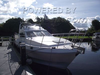

We are in the process of buying a Birchwood TS37 and one upgrade has to be to change the anchor. Currently it has a ship style stockless job athat sits in a moulded in hawse pipe in the bow and I doubt a Delta or RocManson will fit.
Any TS 37 owners have any bright ideas please?
Fortress does fit and by far and away the most popular fit in a google image search
Bow roller fitted
could you mount a bow roller assembly on the prow, then you could fit a variety of different anchor designs
There is one for sale with an add-on like that but Ihoped somebody might have a similar boat and the ultimate answer. A Fortress for sure would fit in the hole but knock chunks of the gel coat every time I suspect. Ideally I would prefer a Delta or even a newgen type Fitting a deck mounted roller will need serious backing plate reinforcement .
