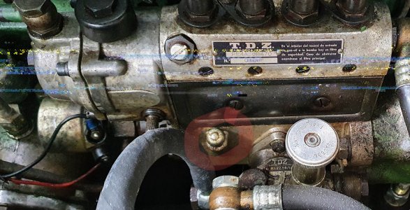

thank you for your reply can L ask question about the bosch injector pump, does this get topped up with oil if so what type
Yes, through the dipstick hole. Over time the oil gets diluted with diesel. As you add new oil you'll find diesel is displaced which comes out below the pump. The Diesel is lighter so floats on the surface. I just used same as in gearboxes, Gator classic SAE30.

thank you, is there an oil level mark on the dipstick or is it a screw you loosen i am showing my ignorance sorry

There are different types, circled mine here. It's a mini dipstick that you pull out. If you overfill it, the excess diesel oil will just overflow underneath.
