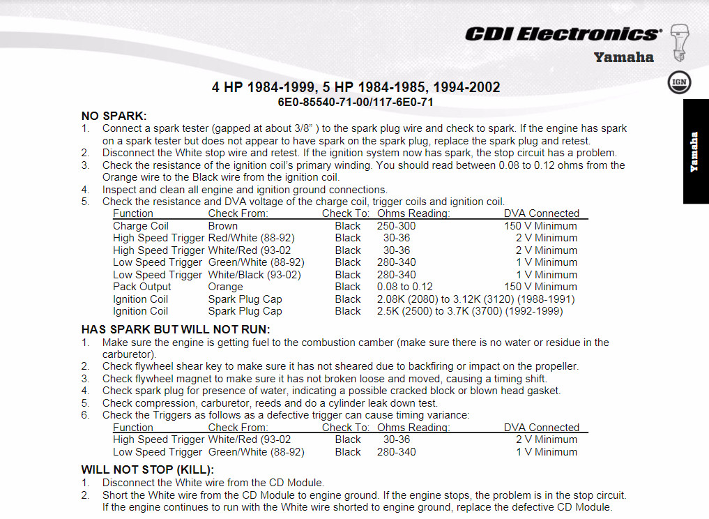

I think it is almost certainly the CDI unit and I have found a further online document about how to check and what readings to expect. I will take a good meter back on my next visit and a homemade flywheel puller so that I can check the magneto coils and wiring are intact.
Before I go back are there any other suggestions? of what to look at an test , including test method.
