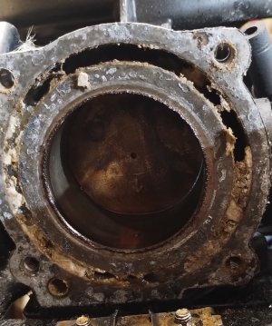

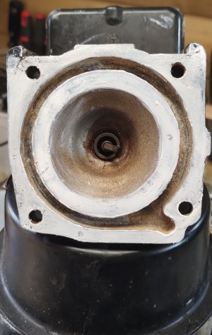

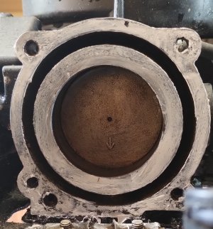

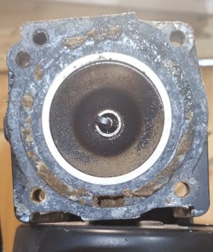

My Mariner 3.2 OB water telltale finally went from a dribble to zero, so time for head off and clean out the water way.
I did the same job on a Suzi 2.2 some years back and the waterway around the head was narrow and quite convoluted, the Mariner was large and simple, so a straightforward job.
