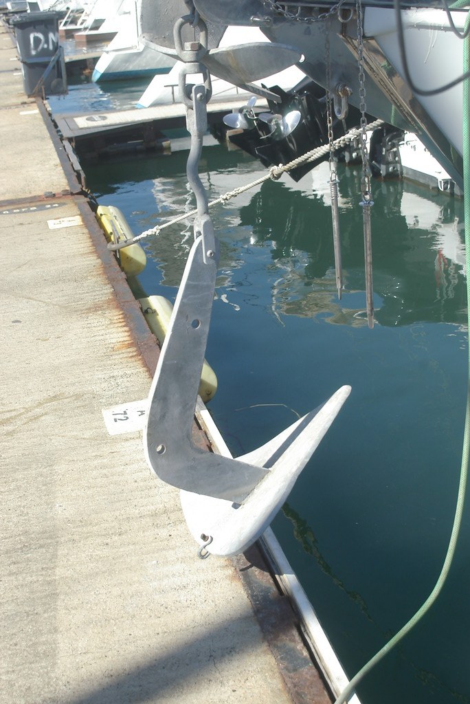

I have drilled 20 mm dia holes in both my anchors before I had then galvanized.
BTW I fabricated all my anchors but I very really anchor along our coast.
Note the 2 20mm dia drop nose pins attached with chains in case I drop the pin.

Roger,
I do respect your opinions in this forum, perhaps because I admire the work you have completed for a yacht I can admire
BUT, there is not always a but - except in this case.....
Can I suggest you separate your bent link, that self rights the anchor on retrieval, from the shank by adding at least one shackle and if you have room a couple of chain links. I may interpret incorrectly but your bent link (aka Boomerang in Neeves' speak) extends the shank, or the lever arm of your shank, by 30% -50% and were you to have your anchor well set, or irretrievable (except by diving) - you may bend something, possibly the bent link.
You also appear to have a 'conventional' galvanised swivel from the lifting industry, a stainless swivel from a local chandler AND the bent link. This looks like redundancy gone mad - you either need one swivel or a bent link and certainly not 2 swivels. The stainless swivel might be held together by a very questionable weld - and unless its top of the range (I'd dump it, now). I suspect the swivel that I identify as coming from the lifting industry is a G30 model, which should have been batch tested and you can see the quality of how it has been constructed. I have tested these swivels and they generally fail where the 'D' link is welded on - but the stainless marine swivel usually fails for some hidden defect 'inside' the barrel.
Finally swivels actually don't work, by them selves, they only work with manual intervention. I'd suggest allowing twists and hockles in the chain to fall out with torque and gravity and just use the bent link, separated by a couple of chain links.

Yes you are correct the banana is in the wrong place and the 2 swivels are not required. I have in fact modified the banana as the anchor attachment some tines turned the anchor the wrong way so the anchor came on to the bow roller 180 degrees out.
I as I said I don't anchor much so low on my to do list.
