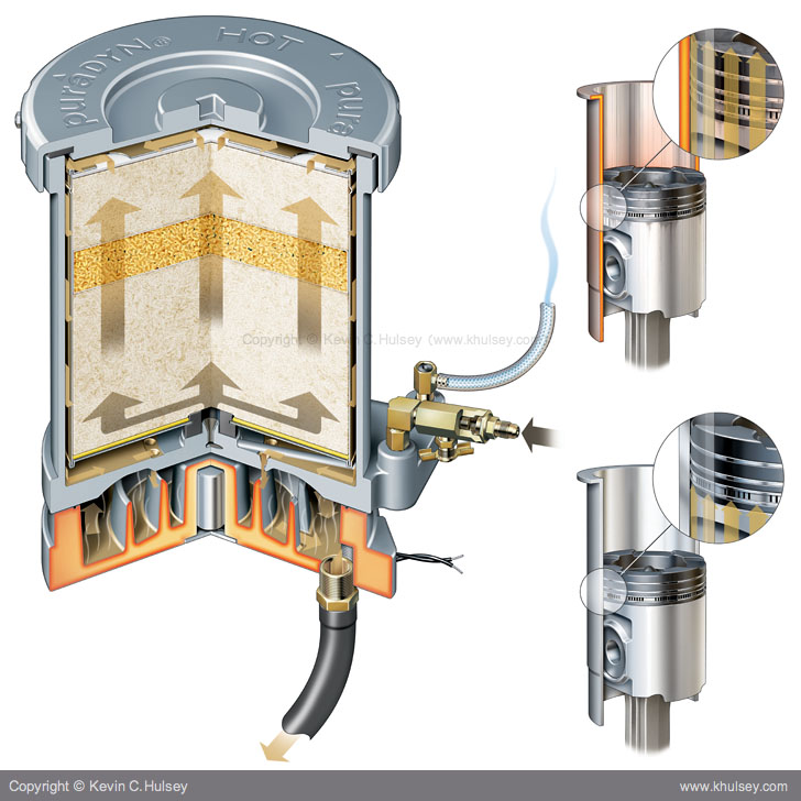

Is this any help?
Yes it is, thank you. The cap does lift off, it just needed a bit more enthusiasm than I'd had!

No no no.................
Complete junk!
Unless approved by Volvo Penta which I doubt these filters actually remove components in the base lube additive which leads to a rapid decline in in TBN.
Simply a bog roll in a fancy tin can, all smoke and windows!

I do not do V.P. stuff but in automotive not aware that they offered an aftermarket system.
Cat, Cummins, Volvo (automotive) have a very oblique approach to this style of bypass filtration, 'they neither approve or disapprove of its use'. Mercedes Benz (Detroit, MTU) are far more assertive in their oils handbook, in that they expressly disapprove of the use.
The oil additive pack among the sexy chemicals contains metals which actively react with the other components (I m no tribologist), filter part of the additive pack and it degrades more quickly resulting in rise in TAN.
Long drain oil solutions work because as oil degrades engines start to consume lube, you top up more frequently restoring the additive pack, and the cycle continues, however in the long term engine develops an increasing thirst for lubricant. People will tell you that you can double, even triple manufacturers recommended intervals with no ill effects using bypass filtration. Simply not true.
