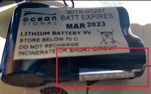

The original battery pack was a sealed three elements Duracell or Energizer, IIRC they are of the type with welded tabs which have to be closely soldered together and tightly wrapped in thermoplastics, being unable to do that I bought the ready made pack. Same identical Duracell type of batteries.
This is the one I bought (note I am referring to their PLB1, not the AIS beacon), surely there are several other different sellers on the internet
3-DL123A 901S01227
The Epirb had three packs of three accu each.

Original definitely 3x Energizer
