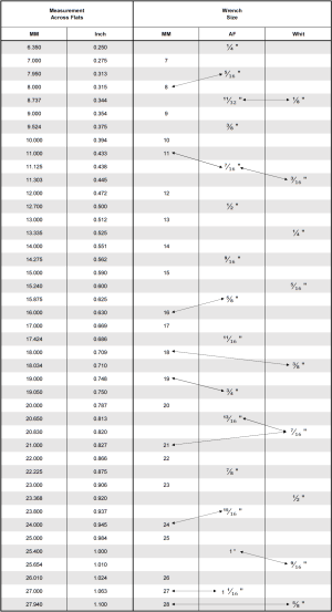

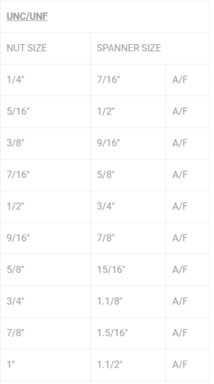

A few nuts and bolts are in awkward to get at locations and my existing metric and AF sockets don't fit well enough. On the metric, 9mm is to small and 10mm to big. Really the same with 3/8" and 7/16" AF.
There was a size, commonly used on boats back then but what was it. BSW comes to mind.
Does any one know of a chart / table where it gives the head sizes in metric and the correct AF, BSW, etc. before I go and purchase some sockets / spanners.

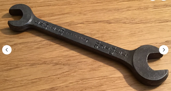

Unlikely but not impossible anyone was using BSW for new construction in the1980's. However, it does depend where these bolts are and what they're doing. BSW can still turn up on hardware and other items. Also pipe fittings invariably have BSW hexagons which does make sense with BSP threads.
Buy single hex power tool sockets. I find them the best for bolts with worn or undersize heads.
1/8 Whit is smaller across the jaw than 9mm IIRC. 3/16 W and 7/16 AF are very close in size. 11mm too.
0BA MIGHT be the odd size you need but quite obscure apart from electrical units.
