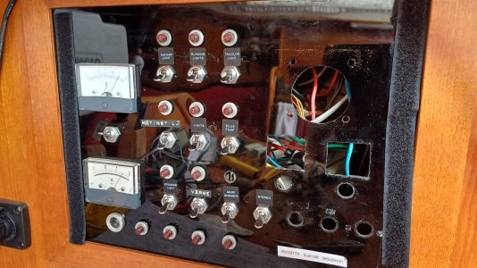

OK ... spenmt most of today with meter in hand ... small screwdriver .... torch and a lot of faith !!
The panel is confusing as you think the reset breaker is one above switch - but in fact its the one below it ... the top are main power breakers for sets of switches !! 10A main at top then 2A and 5A ones on each switch below that ..
The bilge pump was lifted out of keel space and found the case was shattered - probably winter freezing even though I put anti-freeze in the keel space ..
The pump was then shorting when I hit the manual pump switch. Auto lead was found broken ...
The breaker for that switch then fried inside ....

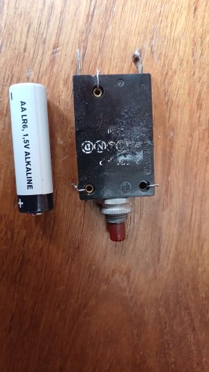

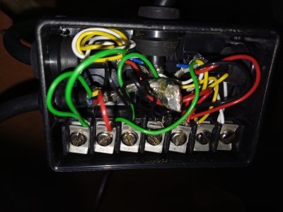

AA battery is to give idea of size ..
Judging by the twisted wires - that case has been opened before !

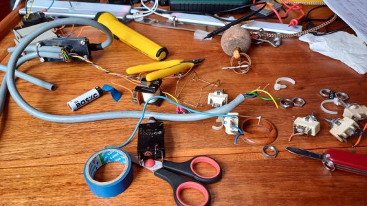

Based on the guys visit other day to the boat and advising that items can be removed from the electricals .... I first got bilge pump replaced and wired up (jumping the breaker till I can put in a new one) ... then started removing the redundant blue box / black junction and leads ...
Switches, trip counters and displays removed ...
The blue box is still behind the panel as the large multi-core black cable dissapears off behind woodwork and I need to find the end to fully disconnect and remove the box.

Managed to find replacement Thermal Breaker same as old ... RS. Ordered.
I am thinking though ... the reset button sits via a hole that a fuse holder could probably fit. Wonder if it may be idea to remove these breakers and fit fuse holders instead ...

He already cracked the case. Frozen bilge pump, burnt thermal breaker. He's already replace both and should be back up and running in no time! :thumb:

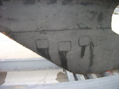

The leak itself ... when we lifted her first time after buying - we noted wet lines on the keel from the plates covering the keel bolt ends ...
We of course removed the plates and checked - but could see no reason for water to get into the keel space as all is sealed behind them ... we reaseled and and covered with 2 epoxy primer and 2 top coats of high copper racing.
Until this latest incident - we've been reasonably dry ..

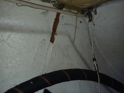

1. Music radio lead to a coax socket fitted to GRP bulkhead ...
Redundant GPS antenna to similar GRP bulkhead connector >

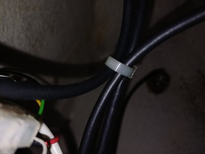

But the worrying thing is ... I finally found where the multi-core black cable from the mystery 'Blue Box' goes to ....
The grey thick multi cable has been disconnected ... but the mutli-core thinner black cable goes to the B&G Junction '7' terminal box !! ... the white metal din plug goes to ??????

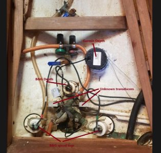

I have a bunch of transducers in front of the keel .... 6 in all ...
The two aft ones .. one has red and other green tape - are speed logs. It appears that they fed up to the #7 B&G junction box and the 'Blue Box' may have controlled which was used by the B&G network ... you basically cannot have two logs feeding pulses to display ...
My next step is to throw caution to the wind and disconnect the 'Blue box' from that #7 junction box ... and pray !!
