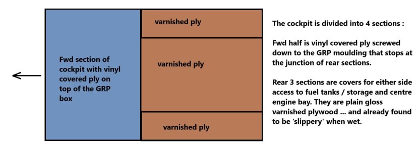

The Primor 24 MoBo I have ... the cockpit sole is divided into 4 sections.
Here you see part of the fwd half that is vinyl covered :
Question is - what to do with the rear varnished ply sections ?
Thoughts of remove the fwd vinyl and cover each section in matching bathroom non-slip vinyl ?? Or use industrial office carpet
