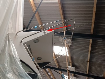

Next step in the mast fabrication. I've got the two hoops made and temporarily fitted. You can see one of the fittings from the first post on the lower hoop where the hoop will bolt onto the fitting making the hoop foldable. At the moment the design looks like a push chair handlebar but the lower hoop also double as a hand rail when climbing out of the cockpit and the whole lot will fold down by pivoting where the end of the lower rail passes into the wheelhouse side.
