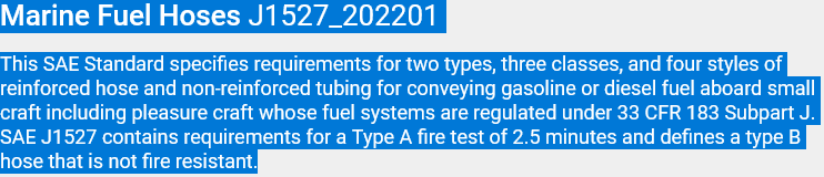

In the US SAE J1527 hoses are required for inboard use. The difference between these and outboard hoses is fire resistance, which explains the thickness the OP reported. Outboards have a different standard that does not require the flame resistance test and carries a lower pressure requirement (outboard hoses are under light vacuum).
